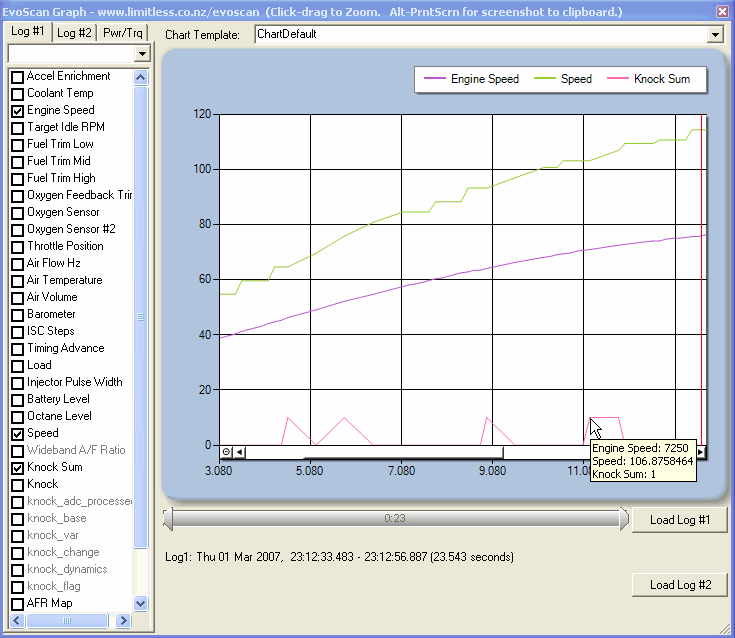

Anyone else having this problem... the graph shows a knock count but when you move your cursor over the point is shows as zero knock.
BTW, i had to change to color of the background. By default, the background was too similar to the lines making it very difficult look at due to no contrast.
Attached Thumbnails EvoScan v0.98 Now with Power & Torque Graphing - Map Tracing completed also!-knock.gif   EvoScan v0.98 Now with Power & Torque Graphing - Map Tracing completed also!-maybe-not.gif

I Updated first post in this thread with some screenies...
