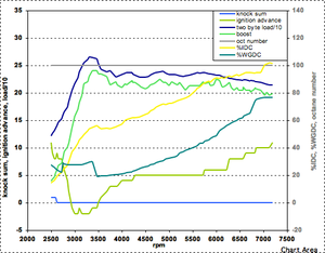

Here's a log I took this morning after a bit of WGDC tuning. Still need more work. Trying to get the boost spike under better control and get a smoother boost and load curve.
Have you tried bringing your WGDC % down at 3,000 to combat that spike?

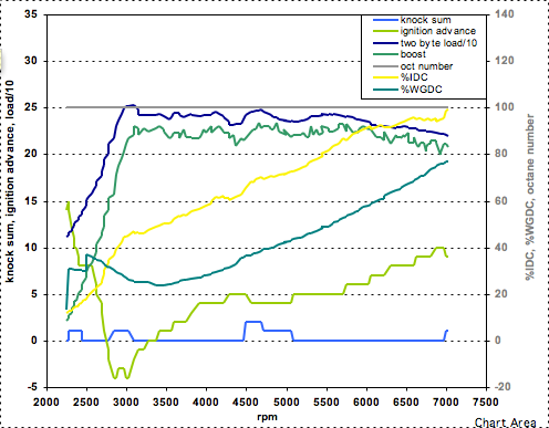

hehe. Just did that this evening. :-) And I raised the MWGDC a bit prior to the spike to promote earlier boost. Seems to have worked. Still have some waviness that I haven't been able to eliminate.
Attached Thumbnails log WGDC in EvoScan-evoscandatalog_2007.03.23_19.45.42_4th.png
MRfred -- What target load / offset are you using and what are your correction factors? The correction factors may be too extreme for your setup, causing the wave. Finally, what load are you hitting in the 3 - 5K range? Thanks
See, that's the beauty of logging WGDC. If you have a look at my plot that you quoted, the WGDC curve is smooth, meaning that the ECU made no sharp WGDC adjustments that could induce the fluctuations in load/boost. (For comparison, have a look at the first plot in this thread where the ECU makes a sharp adjustment in WGDC at 3300-3400 rpm.)
Load (divided by 10) is in the plot. I'm holding about 240 load from 3100 rpm out to 5500-6000 rpm.
