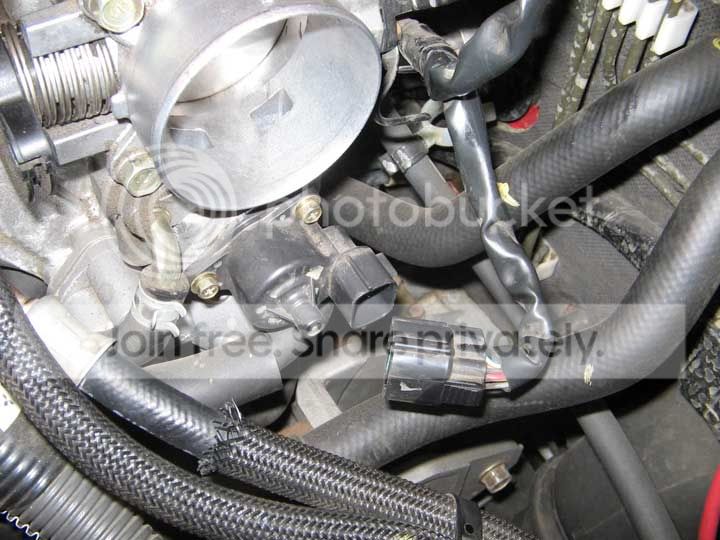

Originally Posted by NIevo
Do you have a picture of what Im lloking for? I just went and looked and I didnt see anything under there that would move?
Just an update but I took it out for a drive today and it wont stay running to save my life. Once at idle its fine, but going from a moving RPM to idle it just wont recover. My vacuum is also at 11 now, down from 15 with the other cams.
the servo is on the bottom of the throttle body under the upper IC hose. If you take the hose off, you can see the servo.
more info here, including pics of the old broken part...
http://www.norcalevo.net/index.php?o...&topic=16998.0
While you are in that area, I would also recommend changing your throttle body seals especially if you have a high millage car.
https://www.evolutionm.net/forums/sh...d.php?t=220264

Anyone have a good pic of the idle stepper motor.. the part that's inside the TB. Mine had a bunch of nasty carbon crap all over it. It could be as simple as spraying some cleaner on it?
I'm not really sure how it works so how do I determine it's not functioning properly? I have mitsulogger/evoscan and such. I tried to take a pic but it didn't come out that great: http://www.justchil.net/gallery2/d/77027-4/000_0069.JPG
PS: I just found this which sounds like my exact problem: https://www.evolutionm.net/forums/sh...t=idle+stepper Now if only I could find a pic of what it should look like
