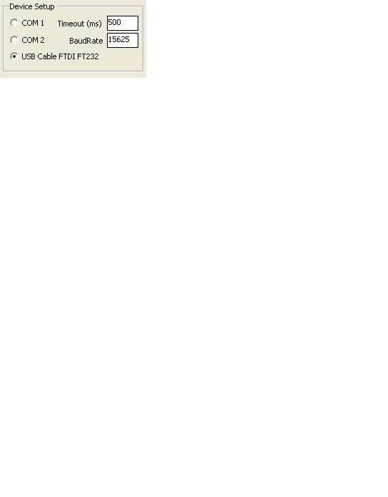

not comport
Your cable is plugged into a comport? I think not.

Wrong, he's not plugged into a "comport".
There is no physical COM port on a computer. COM ports are I/O pathways assigned by the OS and can be changed. I assume that the COM1 and COM2 selections are for cables with a serial (DB9) connection and the 3rd automatically searches for the USB cable on several COM ports. The COM port assigned to a USB device will change based on the order in which the devices are recognized by the OS.
Ok, with that out of the way ... It sounds like a driver issue to me. To troubleshoot, first make sure that a COM port is assigned for the device. To do that, right click My Computer and select properties. Under the Hardware tab, select Device Manager. There should be a category there marked as COM ports (or something similar. Sorry, can't run out to the car and check right now). You Tactrix cable should show up in this list if it is plugged in and installed correctly.
If it isn't showing up, try going through the uninstall process for ECUFlash and then delete the remaining directory after the uninstall completes. Re-install and see if it helps. If not, try to find another computer to test and see if it's recognized there. If not, it could be a cable issue and you might need to contact your cable vendor.
Hope this helps and good luck.

G thanks.
Just select "USB Cable FTDI FT232" and be done with it.
