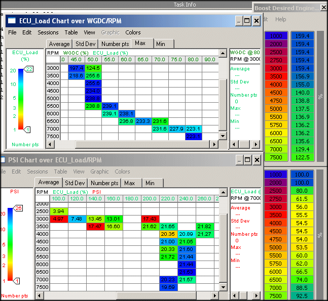

I think the most important thing here is to choose the correct size pill for the boost target that you want to hit. Using the #65 pill I was able to achieve ~21.5 psi and hold it all the way to 7000 rpm. I was also able to be very very close to the BDEL target w/o even touching the TBEC tables. IMO, you do NOT have to zero these tables to get close to your BDEL target.
The screen shot below shows the actual boost and Load (BDEL+BCLO) as well as the WGDC and the BDEL target. BCLO is set @ 100. I took me three logging sessions to get this right.
This was done on 91 pisstane with 1 count of isolated knock.
