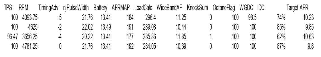

peaking at 297 (27 psi peak boost on my VEI digital gauges)
probably even more now since I have fitted my 3" Miltek exhaust
