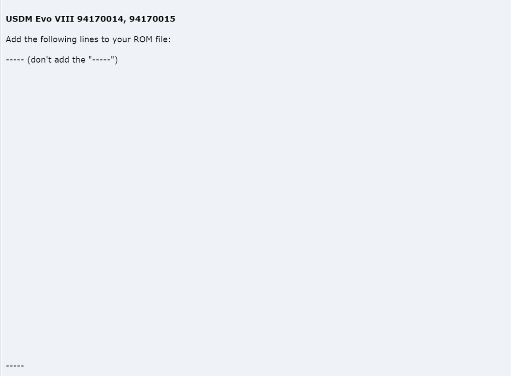

Hello.
I can't see the code that we have to add to our xml files. My ROM is 94170015, could someone please help me? I have tried on many computers and phones, with the same result. I need the tables for Ecuflash, also the scalings, and also the code that we have to add to Evoscan. Thank you very much.

Found a solution. By quoting the message where I couldn't see the code, I can see the original raw text. Still, i don't know why I am having this issue. It is with any thread that contains code.
