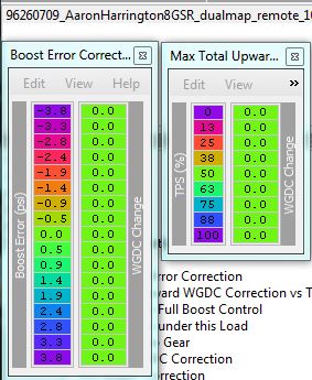

Old Mar 11, 2014 | 06:55 PM
  #1058
azzaevoviii's Avatar
Joined: Jul 2012
Posts: 10
From: Sydney, Australia
yes
this was how i had it during tuning of the bwgdc

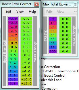

this is how I had it after tuning and correction turned on, logged showed it overshot the targets but didnt try to correct at all during the run
