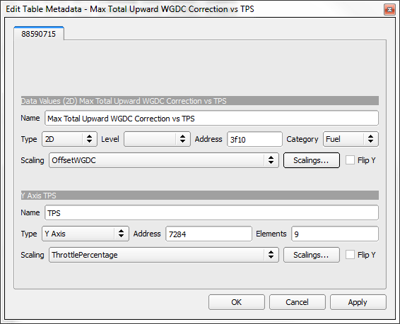

Im pretty sure I have checked every thing and I cannot get my ecu to make corrections to the WGDC. In evo scan this just reads zero in the WGDC corrections all the time, and I have all the values filled in, (stock values, stock solenoid). Also, the max upward correction table is scrambled
Is this a sign of any thing obviously wrong with my v7 rom.
The v7 ROM that you downloaded has an omission in the definition which results in the max upward WGDC correction table not displaying properly. Right click on the table on click "edit map". Make sure everything in there looks like this:
Attached Thumbnails how-to: ECU-based direct boost control-tps.gif
