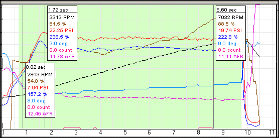

I keep lean spool enabled. I extend it from 2500 rpm to cutoff @ 7700 rpm. Lean spool is disabled by 7000 rpm in the stock rom. The AFR on my car is flat. Here is a 4th gear pull:
12.5 AFR during spool up
11.7 AFR @ peak
11.1 AFR by redline
Boost @ 22 psi peak and holding to 19.xx by redline
On 91 octane with random 1 count of knock.
