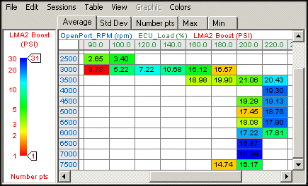

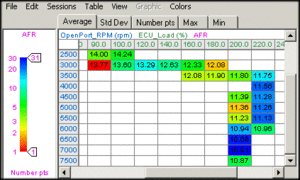

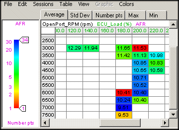

Yesterday I installed the TBE that I had on my 8. It is a JIC dp, an Invidia N1 exhaust and a HFC. I love this set-up because it is quiet, light, and makes power.
I also extended the lean spool from 7000 rpm to cutoff. Thanks mrfred Then I went logging. I was amazed at the difference that the TBE and the lean spool made to the car. When I logged the car prior to this, the car would fall flat on its face after 7000 rpm due to disabling of the lean spool system. After extending the lean spool, this no longer happens and the car pulls like a freight train all the way to cutoff.
The AFR also leaned out to such an extent that only minor adjustments are now needed to hit 11:1 AFR.
The boost also improved and held better to redline than before. Again, only minor adjustments are now needed. Keep in mind that I run on 91 octane fuel and cannot run a lot of boost like the 93 octane folks.
Here is some data to share with you. The data is based on three logs stock and three logs with TBE and LS extension:
AFR stock:
AFR with TBE and lean spool extension:
Boost stock:
Boost with TBE and LS extension:

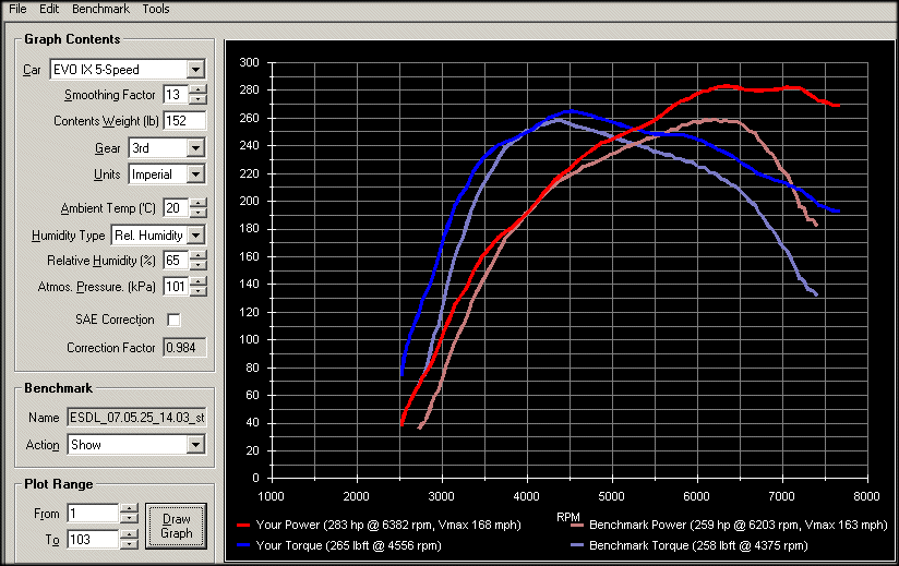

And for the grand finale, the power gain. The car gained 24 hp on DLL and 7 ft-lb of torque and that is w/o any real tuning. OK, you can call the LS extension tuning if you want. Notice how the hp curve holds almost steady all the way to cutoff while before the curve fell after about 6500 rpm. This is, in part, due to the stupid lean spool disable @ 7000 rpm.
