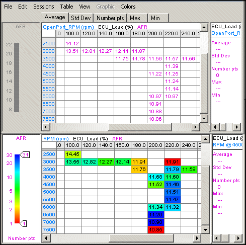

I wonder if the anyone can explain this to me. Yesterday I logged with the stock mivec map. Today I logged with the JDM RS mivec map. I barely made any changes to the AFR map.
Yet the logs today show a 0.25 point leaner AFR than yesterday. Is that due to the aggressive mivec map of the JDM RS? Why would this happen?
Here is the chart the top one is before and the one below it is the after (mivec).

I reconfirmed my findings today about aggressive mivec making the AFR slightly leaner. I did three logs with the JDM RS map and got the same leaner results that I got before.
If you do not want to retune your AFR multiple times, it is adviseable to start the tuning sequence with the JDM RS map first.
Kudos to TTP for suggesting that in a different thread.

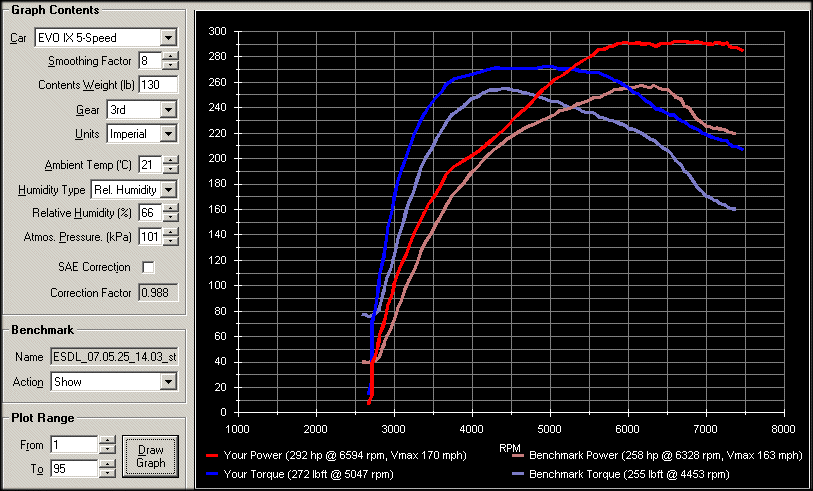

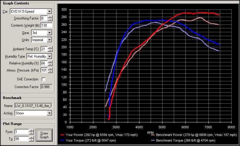

I just want to share my latest data on test pipes. I always wanted to confirm for myself how much power can be gained from a test pipe. So I installed one did a few logs to tune the AFR due to an exhaust leak and today I logged the car. My car gained 13 hp and 6 lbft of torque from the test pipe. These findings are in line with the ~ 10 hp gain reported by others.
Here is the dyno chart of my best run with the HFC and the best run with a TP:
The car is now putting down 34 hp and 17 lbft of torque more than stock simply using a TBE w/tp, leaner AFR, lower timing @ the top end and more timing at the low end and an ggressive mivec map that I found in the mivec thread. I have not even touched the boost yet and I am thinking just to leave it alone even though I produced the pills to do just that
Stock vs. most recent tune with TP
Attached Thumbnails What a difference....-my9_hfc_tp.gif   What a difference....-my9_tbe_tune2.gif
