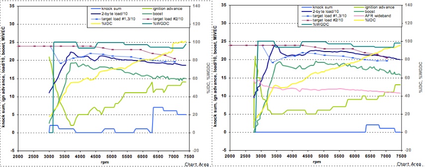

Originally Posted by nj1266
I am using the stock target loads. If you have a stock evo 9 rom then you have the loads I am running.
One question, though, I was under the impression that the target loads are to be left stock until we modify the boost with the pill. Can we change the load target w/o upping the boost by changing the WGDC settings?
The stock ROM uses two different target load curves. #1 and #3 are identical and less aggressive than #2. It seems reasonable to assume that the ECU uses #2 after warmup, but, in the instances that I've seen, it does not. Your log data are below with both sets of target load curves. Your stock run is on the left. Your TBE tune is on the right. For both runs, the ECU looks to be pulling back boost when the load shoots past the target load during spoolup. That indicates to me that the ECU is using target load curve #1 or #3. Don't know which or why.
Anyhow, to answer your question: yes, no reason why you shouldn't tinker with the target load even with the stock pills. You could probably achieve a more consistent load curve if you changed the BDEL tables #1 and #3 to match #2.
BTW, it looks like you've moved the leand spool disable rpm out to 7500 on your tuned ROM.
