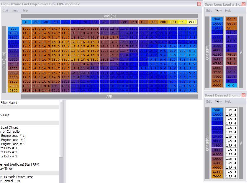

Grr...Im missing something...23.5 MPG today...
Here is my af map (low oct looks similar), open loop (1 and 2 are same), and boost engine load tables.
Am I missing something? Should I go to 40 in the open loop tables or up the cells in the af map (make the values 15.7 cross the board)?
Or is this a pipe dream?

I have my target afrs modified all the way down to 20% load row and of course have open loop load down to 20 in the 2000-2500 cells.
What AFRs are you running at cruise? If you get it in the 15.7ish range your probably not going to see any more improvement by going leaner. For reference I test mine at three speeds (40, 55 and 75 mph) and then see what loads and AFRs I'm hitting. There's nothing really important about those speeds other than those are the areas I find myself in my daily drive.
Finally, if you're not spending the vast majority of your time cruising with little throttle changes you won't see 25 mpg. 23.5 is not that bad if this is the case. I just got under 22 on my last tank, but I was doing alot of WOT pulls to tweak my boost control tables.

I dont have a wideband...yet...ya I need one...
So I cannot say what the exact AF's are cruising.
The last 260 some odd miles were straight I275/I75/I280/OH Turnpike so a constant 80 mph for 3 hours.

If you are in the loads that this effects you shouldn't be making any boost whatsoever, no matter what boost controller. If you are in boost you are already in higher load cells which would most likely make the car richer than stoic. ymmv depending on tune.
I had a chance to do another road trip down the long 5 freeway this week, the same trip I took earlier this year with the open loop trick that netted 25mpg. Without this open loop trick I averaged 24mpg.
Not really worth it to me. Others might have better results.
