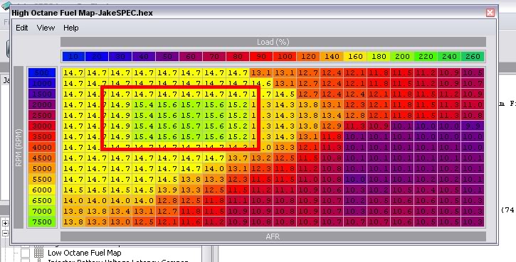

Originally Posted by JohnBradley
NOW, go to your high octane fuel map and in the areas between 40-80 or so, alter them to 15.4-15.7 with 15.7 being a peak value at about 60% load.
Would you mind showing this section of your high octane map?

I will tomorrow...I dont happen to haVE it at this particular workstation
Old Oct 15, 2007 | 11:19 PM
JohnBradley's Avatar
iTrader: (30)
Posts: 11,406
Likes: 78
From: Northwest
Okay apparently I had enough time to get it done tonight so here it is:
and like Plano said I am steadily working myself out of a future job so please appreciate this.

Thanks for this info, i'll see how these changes help, I'm getting real crummy gas mileage still (210-225 full tank w/mostly highway miles)
John,
Should I just log partial throttle then to get an idea of open loop?
Also, in your high octane fuel map you've adjusted the fuel up to 3500, you think there would be any adverse effects if I did this all the way to 4000 since I'm a 5-speed it would be more beneficial for me as im crusing at higher rpms at the same speed.

so what do the 5speed owners set it up to? i usually cruise between 3200-4000rpms..

+1 on the 5 speed 4000 rpm's.
