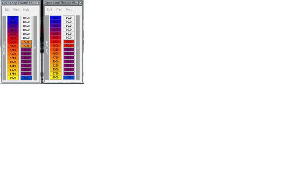

Could you post the maps so we can have a visual? Could you tell us why you used these numbers?
Old Dec 4, 2007 | 12:09 PM
lemmonhead's Avatar
Joined: Nov 2006
Posts: 1,296
From: wexford,pa

can you please elaborate why you feel that changing the tps tables are the better option for making the car stay in open loop than changing the load tables?

So with this, no changes need to be made to the fuel tables? If so, which cells exactly?
