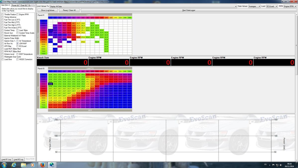

I learned something, I thought if I leaning from 9.6:1 to 11.2:1, the engine would knock more with the same ignition?
How can I accurately identify differents cells in the fuel map ( idle/cruise, spool, peak?)
I don't have table called "OL vs RPM tables

From: REUNION
I have tried to log 'jdm map" too and for me the values have no sens.
I have 15 psi at WOT on my mechanical gauge and the values are very different in evoscan
Look at my log please
I would have preferred the values in "bar"
Do you actually have a JDM map sensor? If you only have a stock usdm sensor the scaling would more than likely be off, explaining why ur logging 32.x vs 15.
Yes I have a jdm map
Hmmm, do you have to subtract out atmospheric pressure (14.7psi at sea level)? That would get u closer to the 15 psi ur gauge is reading
my eval for jdm in evoscan is 0.19347*x-14.7.
Need I to subtract 14.7 in this eval? (0.19347*x-14.7)-14.7?
