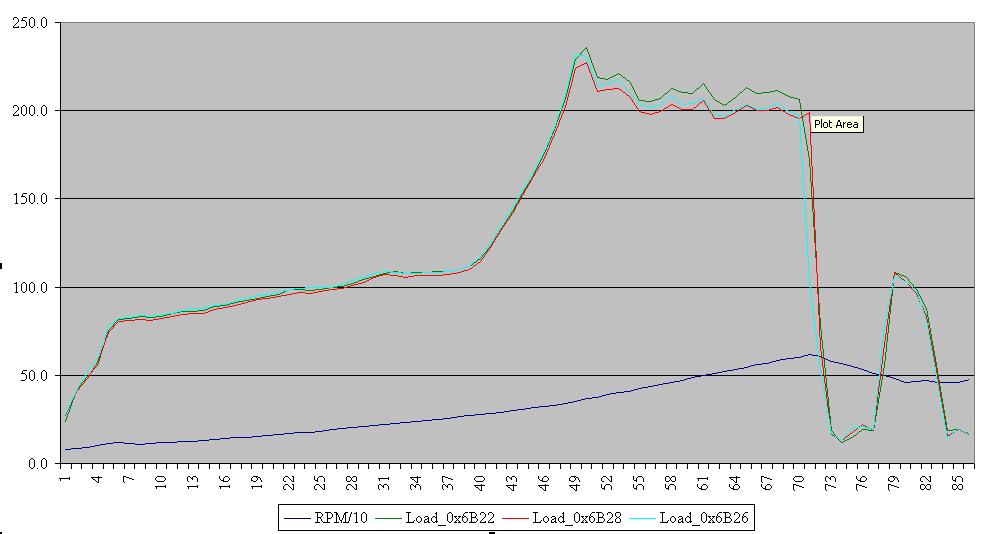

I did a log of the three load variables that are used in Fuel and Timing routines;
0xFFFF6B22 and 0xFFFF6B28 are used for Fuel, there doesn't seem to be any reasoning behind the choice of these 2, I have logged the variable that makes the decision as to which (22 or 28) load var to use and there doesn't seem to be any correlation to events in the car.
0XFFFF6B28 and 0xFFFF6B26 are used for Timing, it would appear that the ECU uses 26 when the air_temp's are above 65 which according to a log is basically all the time.
note - these variables are only good for 88580013/14 ROMS they wont mean anything in the other ROMS.

Interesting results. Looks familiar...a lot like graphs that Bez posted in his SD research, if I am remembering correctly.
Have you read through that post on AktiveMatrix before? Maybe it will give you a bit more information that you are searching for. I have no skills in disassembly, so I can't help you with this.

so far, basically:
0xFFFF6B22 = MAF_SOURCE_0 * maf_size (value is 0x9884 in my ROM)
0xFFFF6B26 = 0xFFFF6B22 * some baro thingy / 128
Old Nov 15, 2007 | 10:18 PM
tephra's Avatar
Joined: Feb 2007
Posts: 9,486
Likes: 67
From: Melbourne, Australia
Ok this is interesting,
0xFFFF6B22 is the 2byte of MUT1C before the 160max gets applied.
0xFFFF6B26 is a baro compensated 6B22
0xFFFF6B28 is a baro AND temp compensated 6B22
0xFFFF6B24 is a temp compensated 6B22
Now 24,26 and 28 also have 160max MUT's just like 6b22 (...MUT1C)
