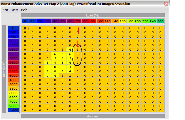

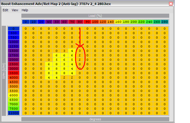

Depending which lower cell values you eliminate you shift the timing to higher load
...in this example Stock timing is at 70
After eliminating the 30 column loads are shifted to the left and timing values end up at a higher load.
The more lower load columns are eliminated the more additive timing end up in the tip in or spool areas

Seems like a potential issue for other situations where a set of axes serves more than just the table where the user is looking to make the change.

Ouch. And I just eliminated a few more of those columns to get more resolution in the 220-250 load areas . I removed 30 and 70 which means that now those tables extend into the 90 load column.
-snip- -snip-
Woah, that's an awesome point. I have been chasing some damn knock in another thread in the 70-90 areas under light loads.. I bet this may be the cause... I might have to start playing with those maps now...

the only draw back is that mpg may suffer . I adjusted(or eliminated) the timing to correspond the original values in the 70 load column.

BTW I also corrected the values shifted when rescaling load in the Boost Enhancement Enrich/Enlean (Anti-lag) Map ( the one that displays AFR in a timing map)

I moved these over to their appropriate positions based on my current Load/RPM scale. Lost a bit of resolution but I think it should be fine.
