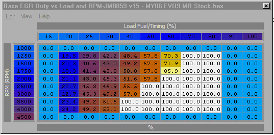

I've worked many more of the details that control these advance tables. C6C6CH3vo was exactly right about these tables. These timing tables are used *only* when the EGR valve is open. There are a few other conditions that control the usage of the tables. The tables are skipped if the IAT and coolant temp are below minimum values. And the tables are skipped if the TPS is below a minimum value (17% TPS). Details follow... I'll start off by relisting the old tables and then listing the new tables that I found (88590015 ROM, ECUFlash 1.34):

Also there are two scaling definitions that need to be added to the evo<7,9>base.xml file:
<scaling name="EGRDuty" units="%" toexpr="x/1.28" frexpr="x*1.28" format="%.1f" min="0" max="100" inc="0.1" storagetype="uint8" endian="big"/>
<scaling name="EGRDutyCTFactor" units="Fraction" toexpr="x/128" frexpr="x*128" format="%.01f" min="0" max="1" inc="0.01" storagetype="uint8" endian="big"/>
Notice that I've changed the name of the old tables from "Dynamic Advance" to "EGR Enabled Advance". This name more correctly describes their function. The third table in the list is the base EGR duty cycle vs rpm & load. Its a pretty self-explanatory table. The fourth table is used to adjust the Base EGR Duty as a function of coolant temp. Whatever value is looked up in table 4 will get multiplied times the value looked up in table 3, i.e., table3 * table4 = applied EGR duty cycle. The 5th table appears to be some sort of alternate means for determining what EGR Duty to use. Under certain conditions, it gets used instead of the table3*table4 value. I don't know what the conditions have to be for table 5 to be used. There are three flags that that I have not tried to figure out yet that determine when the alternate method is used.
If you'd like to log EGR duty, its at MUT85. Here is the entry to add to EvoScan:
<DataListItem DataLog="N" Color="" Display="EGRDuty" LogReference="EGRDuty" RequestID="85" Eval="x/1.28" Unit="%" MetricEval="" MetricUnit="" ResponseBytes="1" GaugeMin="0" GaugeMax="100" ChartMin="0" ChartMax="100" ScalingFactor="1" Notes="" Priority="1" Visible="false" />
That pretty much covers what I figured out. There are several misc 1D tables for coolant temp, IAT, and TPS, but they're really not worth presenting. They just keep the EGR system from operating during non-optimal (i.e., engine warmup) conditions.
Base EGR duty vs load and RPM
Normalization for coolant temp
Alternate table for determination of EGR duty

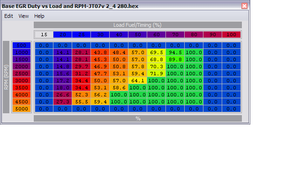

Originally Posted by mrfred
Its going to depend on the which Evo 8. :-) Hoping that some of the people on the board can find these for other ROMs. If no one has any luck, I can look.
Rom id 9714008
Using the guestimation method (using relative offsets from evo 9 rom)and luck
I found 2 tables
EGR 1?? table address="46c9
X axis address="67f6"
Y Axis address="6876"
EGR 2??address="4743
(Don't know if the x & y axis are correct.)
It looked like there was a 3rd table around there too.
