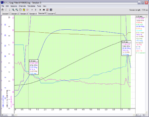

I used the MAF baro following the same criteria for other filter tests here.
Using openport1.3 and logworks to datalog, idle it will register 14.87 psi and at WOT the pressure will drop to 14.13 at 7.2krpm, a pressure drop of .74 psi (there was no diffrence in pressure drop between samco and oem tip.)
OEM filter and unmolested box cover the pressure drop is about 1.13 psi.
Using a cone filter pressure drop is about .5 psi.
the brown line in the chart is the pressure drop trace of a oem box with drop in filter and cut top cover.

That was measured at the MAF, right? I want to be sure I'm understanding correctly.
Old Jan 16, 2008 | 07:21 PM
Jorge T's Avatar
Posts: 1,494
From: Houston, TX
correct.

In that case the effect of a new inlet hose would be very very tough to pick out since it is a downstream effect.
A similar thing would be to determine the pressure drop of a new throttle body by taking a pressure measurement at the discharge of the compressor.
