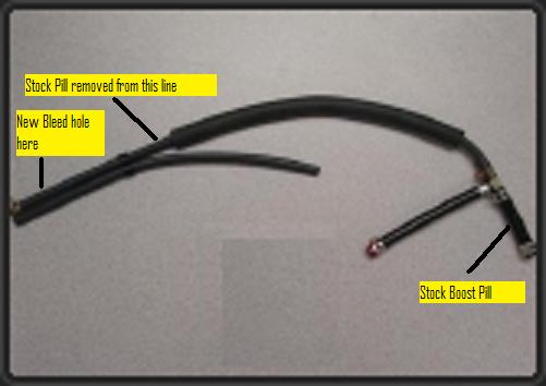

Originally Posted by mrfred
- Stock BCS
- Stock pill at the tee
- no pill at the BCS
- bleed hole (to atmosphere) in the boost hose just before the BCS
So something like the picture attached? sorry for the crappy resolution.
how big of a hole in the boost line?
I assume the hole just allows for more boost to be bled off prior to the bcs taking over.

Tek3Evo,
Yes like that, but there is a machined fitting in the line by the solenoid with a bleed hole in it. It is a Shivnu thang...

From: Menomonee Falls, WI
got it. was wondering how the hole wouldn't end up growing in size over time.
- Stock BCS
Wow very impressive.
