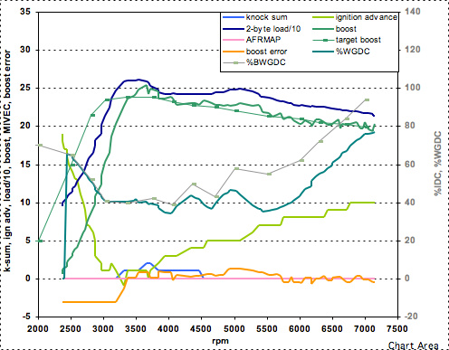

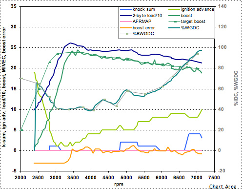

I *finally* got around this weekend to installing my 100 cps cat and RRE stealth exhaust (still using the stock DP). Took the car out for a test drive and didn't notice much difference in performance, but then I looked at the log data and found a big difference there. Apparently the new exhaust pieces greatly reduced back pressure, and in order to keep the same boost levels, the direct boost control system had to pull out a ton of WGDC at higher rpm. It was pretty cool to see the new logs for the first time and realize how well the ECU maintained the target boost level with such a drastic change in exhaust pressure.
Anyhow, I'll need to retune the BWGDC curve soon so that things work as expected anytime I punch the throttle.
Random Tech HFC and stock cat-back: Here you can see that the WGDC is pretty much following the BWGDC curve exactly.
100 cps cat and RRE stealth: Here you can see how much WGDC is being pulled back from the BWGDC curve to maintain the target boost levels.

Cool stuff but how how come the boost error isn't changing very much as well?
EDIT: Nevermind now I see it.

It's because the boost is correct. The WGDC is what has changed. The boost error value is the comparison of desired boost to actual, which are both still very close in this situation.

Yeah, the boost error never gets really big, except perhaps at 5000 rpm where it gets up to around 1-1.5 psi. Its because the BWGDC curve still has the correct general shape, but progressively runs too high as the rpms increase (caused by the decreased exhaust back pressure improving turbo efficiency).

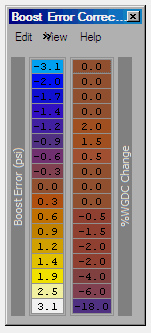

Here is my current correction table:
