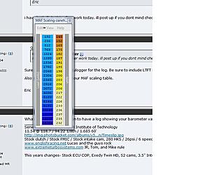

Attached Thumbnails need help with a/f at idel-maf-scaling.jpg

Also post a screenshot of your MAF scaling table.
Eric

i put my maf scale pic in first post

OK, I'm pretty sure I can tell you how to fix this with the MAF scaling table, but first I need to see a few minutes of an idle log. Don't worry about putting more miles on it. I can tell from the STFT and the LTFT.
Btw, your Maf scaling table is stock. If you right-click on the maf sclaing table in ECUFLash and click Edit Map, is your scaling for the X axis uint8? If so, then your MAF scaling table hasn't been changed.
Eric
