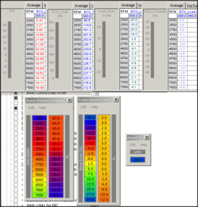

Here is what I have for this Evo 9. TBE w/stock cat and Injen intake w/uicp. Top part is the logged boost, 2 byte load, load error and WGDC correction. Bottom part is BDEL+BCLO and TBEC. 4 back to back logs on 91 octane gas. All numbers are averages.
I want to thank razorlab for the tip of setting BCLO to 200. It makes math so much easier
That looks like my rom. Thanks Naji. And thank you razorlab for the tip, it definitely makes the math much easier!
