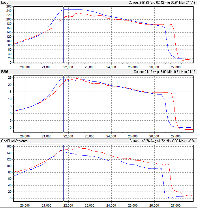

Now, here is data from a Ralliart using SPORT mode and a MR using S-SPORT mode. As most of you know, the Ralliart does not have S-SPORT like the MR.
Both 3rd gear data. Notice the Ralliart in SPORT (blue plots) is running slightly more engine load then the MR in S-SPORT (red plots) but the MR has more clutch pressure being applied.
So do the SST modes translate to increased/decreased clutch pressure? That's next.
