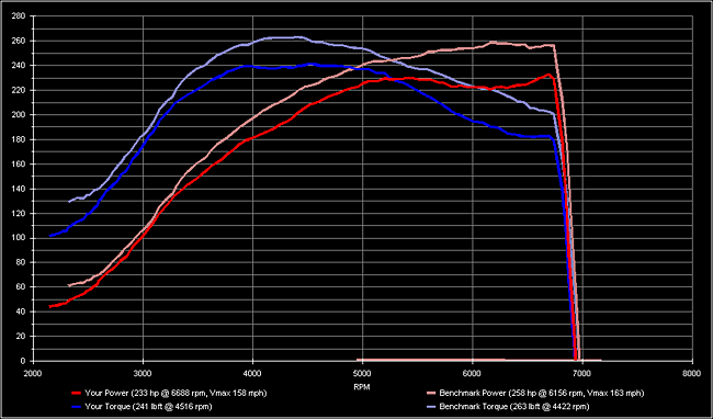

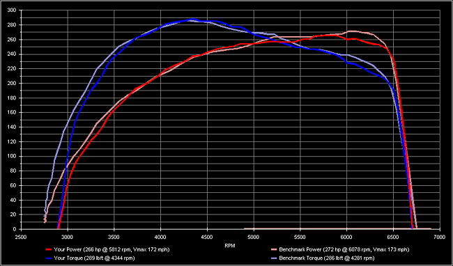

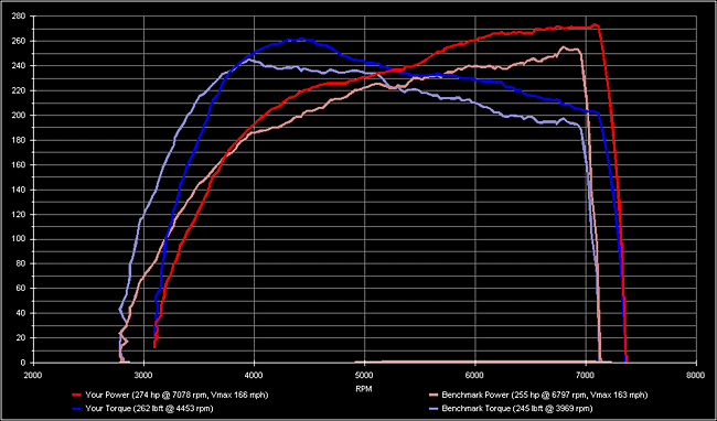

Most of you already know about this combo of tools but I've been using the EvoScan + DatalogLab + EcuFlash to tune a bunch of cars in the last 2 months or so and it's a great combo.
The ability to visualize data with DatalogLab and also to see before and after powercurve changes makes it indispensable in my opinion (this was a big reason I loved ECU+ before). Everyone already knows the power of EvoScan and EcuFlash already so no need need to talk about them
I won't do a total write up of every car but here is some eye candy before and after charts. If anyone is serious about tuning their car well, this combo is hard to beat. Couple it with any good wideband on the market and it's total tuning power to the masses, of course, if you know how to use them to their potential.
Keep in mind these screenshots are showing only some simple logged parameters as to not get too busy but DLL can plot any data log column from evoscan you desire.
I think its amazing that this community has risen up and created their own tools to help the masses understand and visualize car tuning. I've been doing this for 7yrs+ and right now is truely a golden time.
Enough of the soppy crap, judge for yourself the power of the software combo with a couple examples:

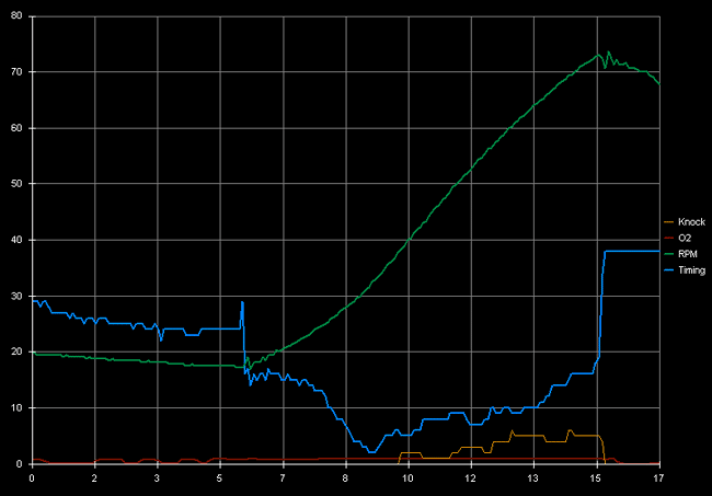

Before datalog visualization:
After datalog visualization:

Before and after overlay DLL power curves:

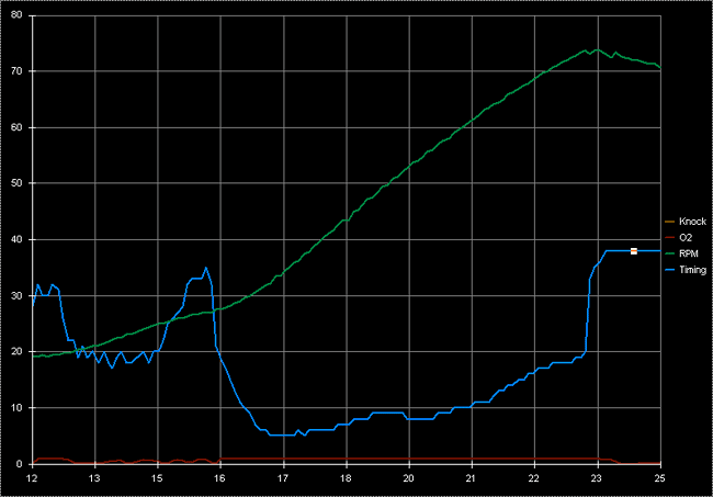

After tuning pull datalog visualization:

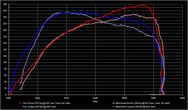

Stock car with catback, before and after tune DLL powercurves:

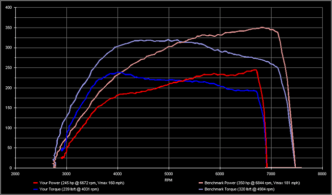

Before and after tune DLL powercurves:

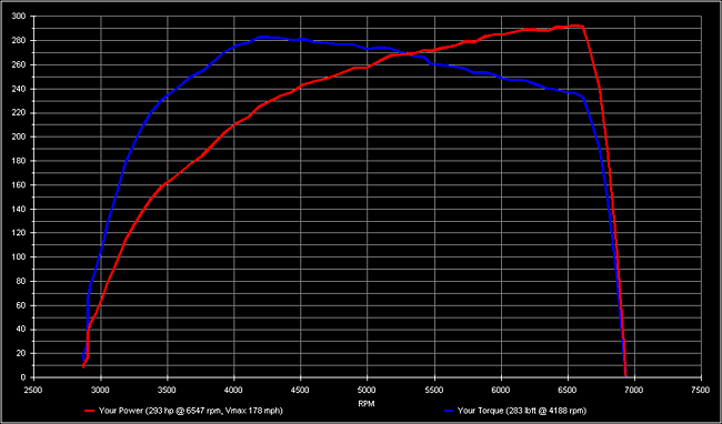

Showing comparsion between stock and modded with tune and 100 octane:
Keep in mind, the DLL powercurves are hard to get exact corresponding numbers to actual dynos, but the before and after curves are what should be looked at.

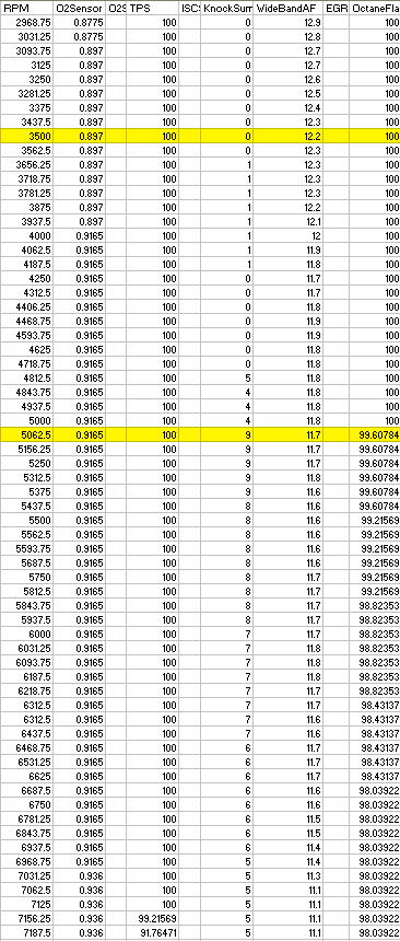

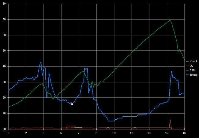

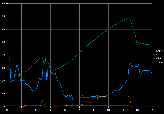

Being able to bring the EVOscan datalogs into DataLogLab and with one click, graphing them out visually, saves tremendous time over looking over huge excel graphs. I do still use the raw excel logs sometimes. With DataLogLab you can switch inbetween the visual graphs and the excel graphs with one click. In DataLogLab, you can click on any point on the datalog visual graph and it shows you the exact data in a left hand column of every piece of data that you have logged at that exact point. Just following the ign timing graph and seeing where knock happens at a glance greatly speeds up the tuning process.
Here is what the full app window looks like:
The power curves give me information on if the car is producing more power or not from changes. I can also roughly find MBT using them as well.

The benefit to DataLogLab is that it tells you exactly how each change affects your power curve. It also makes it easier to smooth your torque curve. It also makes it easy to see how much power each change provides. I believe the cost is around $15-$30 for DataLogLab. I don't really need it, but it is fun to play with and generate dyno plots.
