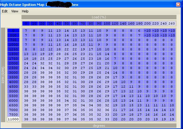

lol @ this timing map...

I guess it was 19 and not 24...but still:

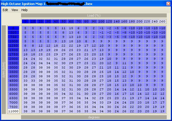

looking through some old stuff, I think I found the worst fuel map I ever had the pleasure of replacing

Someone seriously spent more time f**king this map up than they would have doing it right. Wow.
I think I have actually found worse. To make matters worse, the people responsible for these timing maps are now charging big bucks for evo X "tunes" LOL!

Okay, so the first thing you notice is the map is the low octane map. That was the only map that was tuned, the high octane was stock. Apparently they thought high octane was only for racegas or something. The car had HKS 272s and all the normal suspects but what is up with the 1* at 7500? BTW this map was done by a reputable east coast shop back in the day. I think they probably understand the stock ECU a little better nowadays but the timing is scary.

Its crazy that they knew enough how to re-scale the load axis but not enough to know the difference between hi and low octane maps,lol.
My first tune was done by a reputable shop in Dirty Jerse and it was block tuned as well. If it wasn't for the irregularities with the tune, I would have never ventured on my own and found this forum. So I guess their inadequacies were a blessing in disguise for me

I think a big problem is that most shops with racecars are used to tuning only the WOT cells and then hitting the track. They don't know much about part throttle driveability, changing weather conditions etc. The average enthusiast tuner on the forum with a 11-13 second stock ecu car that drives it every day knows how to make the car behave day in and day out.
