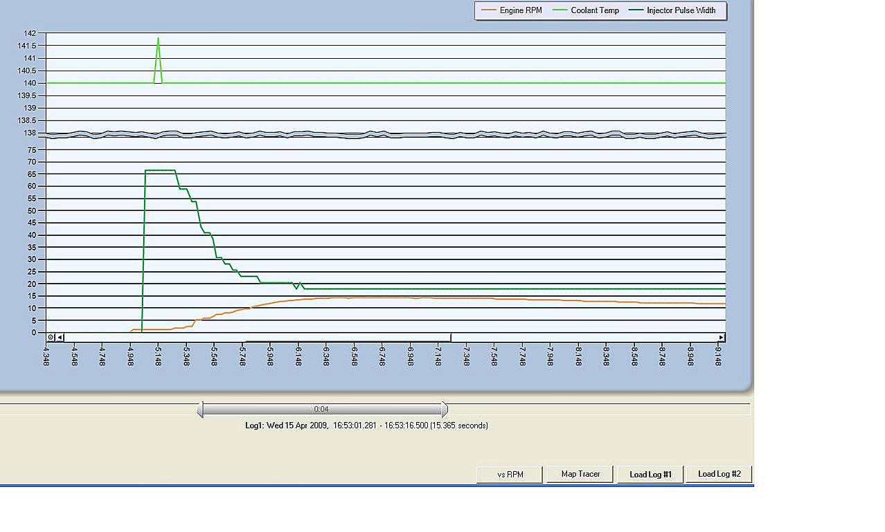

Originally Posted by travman
I'm not sure what you mean by you did it as a function of engine temp rather than cranking enrichment?
I will try logging as you said - I log it to screen and watch while its cranking and then go back after to review the logs closer. No matter the value in the table my ipw is always around 4 on cranking, while my table shows something totally different.
Travis after logging your car this weekend your startup IPW looks like crap. It is jumpy and even has a dip in it. Also for some unknown reason your car went to 1.3xx volts of battery voltage on two consecutive starts. Here is a log of my car starting up fine during the exact same "warm start" of 50-60deg C you are having issues with.
You have something wrong with your car or your ROM. The injectors are fine.
I never blamed the injectors........obviously its my car when i state 2 different sets i experienced this. Anyone who reads this the bosch injectors are awesome, my car like everything else i touch always gives me grief - maybe its a sign?
