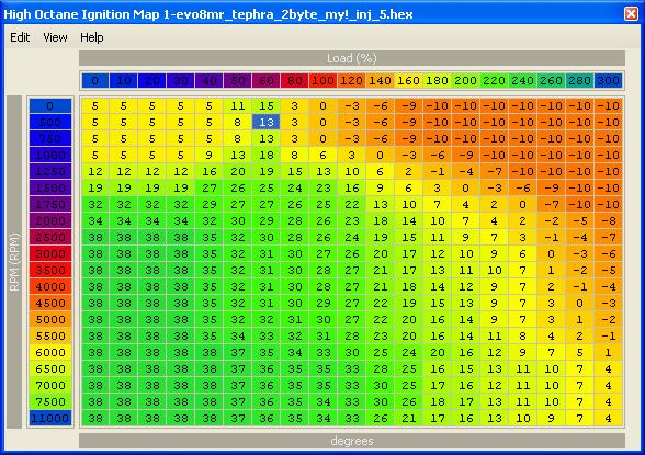

OK. So if you KnockSum=Knockretard - then by getting 10 knock sum you really retard around 3-4* on timing.
Post your ign map and may be some log (TPS, RPM, Load, WB, KnockSum, MAP, IgnitionTiming)
Old Jul 16, 2008 | 01:26 PM
KOTT's Avatar
Joined: Sep 2007
Posts: 125
From: Ukraine
this is my ign map

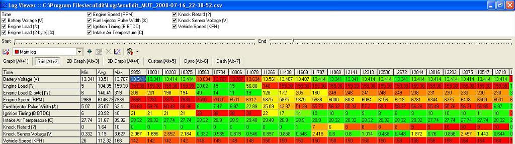

From: Ukraine
part of my log, not worst
Old Jul 16, 2008 | 01:36 PM
burgers22's Avatar
Joined: Jan 2006
Posts: 953
From: Oxfordshire
You look to be running the timing quite high above 6000 RPM, try reducing it in the area were you get knock.

Old Jul 16, 2008 | 01:44 PM
KOTT's Avatar
Joined: Sep 2007
Posts: 125
From: Ukraine
doesnt help(
on "off"(avc-r) i stil have knock((( (~0.7-0.8bar)
i think it maybe something else?
need help...
