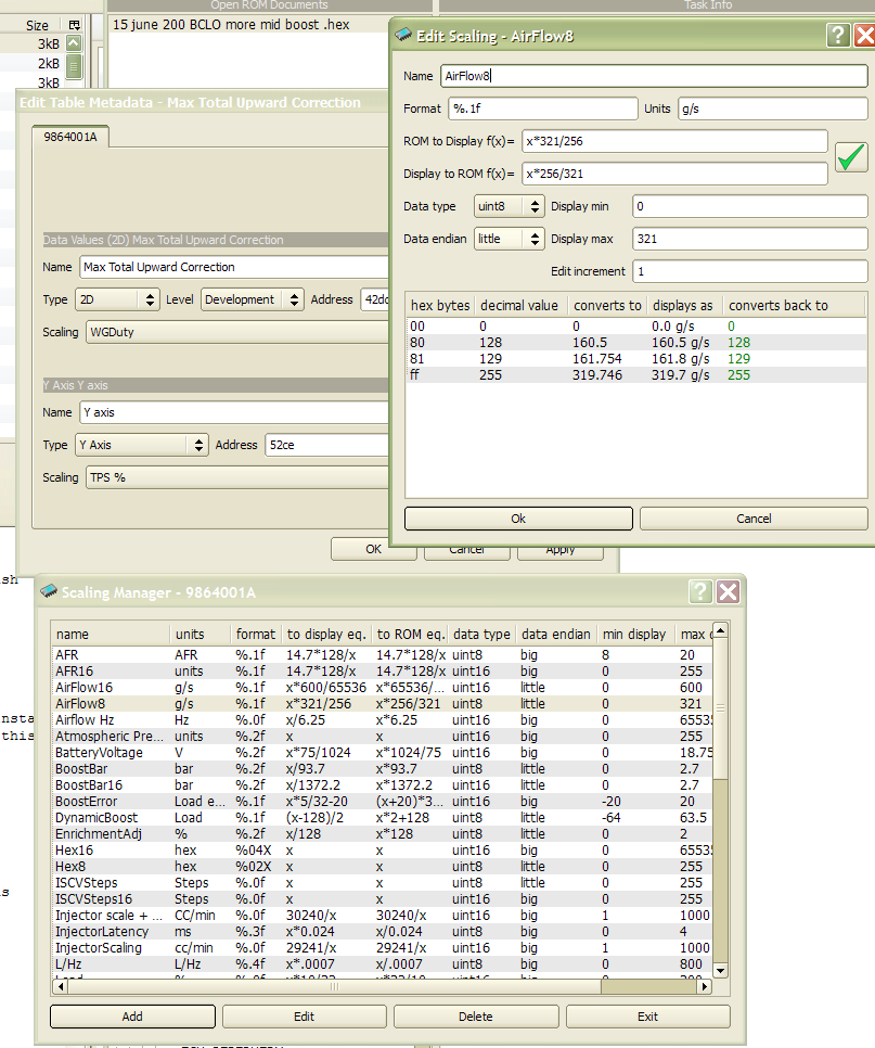

One the scalings via the edit map function and check the edians in use, you can set all to big.
MB
