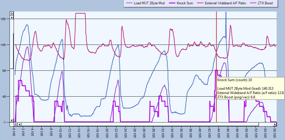

not sure if this has been reported but for some reason the boost limit - RPM values are screwed up on 94170015.
Pic attached
Old Nov 11, 2008 | 12:12 PM
  #581
gsrboi80's Avatar
iTrader: (38)
Posts: 7,909
Likes: 47
From: On a cliff
yea the rpm address is wrong in the xml it needs to be 6dd2

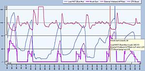

Well I FINALLY remembered to bring my laptop with my on my commute to work to record the low load knock I have been getting. Maybe someone can see something I dont? I added a link below the image for the Evoscan file so anyone can look at it in a graph or in Excel.
LINK TO FILE
