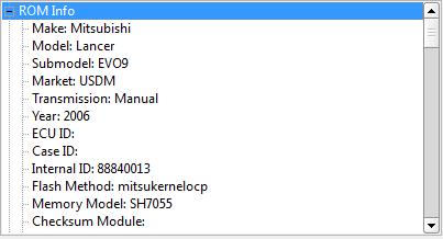

Old Apr 9, 2009 | 09:43 AM
Danieln's Avatar
Joined: Apr 2008
Posts: 563
From: EUROPE
Originally Posted by tephra
88840013 is early euro IX, ie they are upto 17 now.
94170008 is early US 8
80700010 GTA AU...
Hi Dave,
I had before this version of map.
I just wanna know if this map was deliver only to EURO side of the world or not.
Do you know more abiut this?
I`m not so sure that this map was delivered only to EUR side.
Evan if into ecuflash definitions maybe it was a mistake when they made the program and they add into the xml file of 88840013 ar ROM info, Market : USDM......I just wanna know if realy this was only a EUR map id.
Thanks
Old Apr 9, 2009 | 07:05 PM
tephra's Avatar
Joined: Feb 2007
Posts: 9,486
Likes: 67
From: Melbourne, Australia
i think its a mistake.
8884 was only EU AFAIK...
