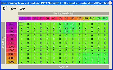

OK, I *think* I found this first map in the 96940011 ROM. Maybe mrfred can verify for me. It looks a lot different than the 885590015 ROM, so I'm curious if this is the correct table.
Anyway, this is what I have, in case anyone wants to take a look:
Code:
<table name="Base Timing Trim vs Load and RPM" category="Timing" address="4c9d" type="3D" level="1" swapxy="true" scaling="Timing">
		<table name="Engine Load" address="65ae" type="X Axis" elements="14" scaling="Load"/>
		<table name="RPM" address="658e" type="Y Axis" elements="11" scaling="RPM"/>
</table>
Edit: Updated with correct address of 4c9d and updated screenshot

I think you are both off in your 3D map addresses by 1. The first number in the map is not part of the map itself, as it is for other 3D maps (seems to be more of a Y axis size indication). Move forward by one and it looks correct.

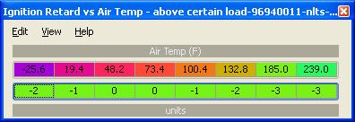

Here are the IAT ignition retard maps for 96940011. I scaled some of my maps to degrees F, since I'm more used to that. I did that for this map, for example, so I will include that scaling for you here as well (you may have to change the endian values depending on your ECUFlash version):
Code:
<scaling name="TempF" units="F" toexpr="1.8*x-40" frexpr="(x+40)/1.8" format="%.01f" min="-40" max="419" inc="1" storagetype="uint16" endian="little"/>
<table name="Ignition Retard vs Air Temp - above certain load" category="Timing" address="388a" type="2D" level="2" scaling="TimingTrim8">
		<table name="Air Temp" address="5ec8" type="X Axis" elements="8" scaling="TempF"/>
	</table>
	<table name="Min Load for Ignition Retard vs Air Temp" category="Timing" address="38a4" type="2D" level="1" scaling="Load8">
  		<table name="Engine Speed" address="594e" type="Y Axis" elements="10" scaling="RPM"/>
	</table>
I don't know enough to know if that 11 is part of the map or not. I'll let mrfred handle looking into that and I will update my post if necessary. I'm not even 100% certain if the maps are correct yet, either, so I will update everything once mrfred has a chance to verify.

They are the same maps from what I can see, but change the address to 4c9d and the map will be correct. It is the same as for any of the other 3D ignition maps. Go back one number in any of your 3D timing tables and you will see the same thing. The same map is in my rom but it is zeroed by dafault, and also has an 11 as the first number. Not only that, but you are missing the last digit of your map :-)
Yep, it does look a lot better. Groups the numbers a bit better. I'll update my post in a bit.
You're right. I never noticed that with 3D maps. The first number after the RAM variables appears to be the number of columns in the table. Updating my first post now...
