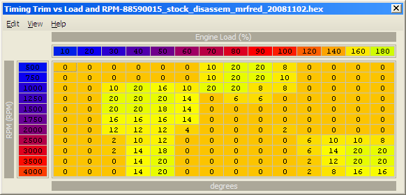

I finally went back to the ignition timing subroutines and dug more of the ignition trims that are dependent on tables. There are one or two more subroutines that I need to look at in more detail, but I think I've got most of the tables. I'll go through them as they are encountered in the code. (I'm not including the cold engine ign timing retard as I've already gone through that set of tables.) These address are for 88590015 Evo 9 USDM ROM. These definitions will be included in a future release of ECUFlash.
EDIT: updated to show corrected Base Timing Trim vs Load and RPM table xml and table picture
Code:
<table name="Base Timing Trim vs Load and RPM" category="Timing" address="50dd" type="3D" swapxy="true" level="1" scaling="Timing">
  <table name="Engine Load" address="7850" type="X Axis" elements="14" scaling="Load"/>
  <table name="RPM" address="7830" type="Y Axis" elements="11" scaling="RPM"/>
</table>
<scaling name="Scale128" units="%" toexpr="x/128" frexpr="x*128" format="%.2f" min="0" max="10" inc="0.05" storagetype="uint8" endian="big"/>
<table name="Base Timing Trim vs Load and RPM Multiplier vs CTS" category="Timing" address="517e" type="2D" level="1" scaling="Scale128">
  <table name="Coolant Temp" address="6fde" type="Y Axis" elements="8" scaling="Temp"/>
</table>
This is a wierd adjustment. It advances the ignition timing in certain load and rpm cells when the engine is cold. Strange that it adds timing out a 4000 rpm and 180 load. That advance will get carried out to any higher loads or RPMs.

Looking at mrfreds first timing map, the additional timing in the block of cells at load 70-100 x rpm 750-1250, would improve off-idle throttle response when cold.
As for the rest???

The map doesnt make any sense. It has values in areas where you will never get to (180 load @ 500rpm?), and adding that amount of timing would make the engine rough with too sudden a change in timing. Unless it is an addition map that adds to the warmup retard to cancel some of the retard out during accel enrichment... just with some weird mapping values. I have not seen this map in earlier roms either.
Its a wierd map, but I did get the map layout correct, and its definitely called in my ROM. Its quite possible that it doesn't exist in your ROM though.

I wonder if that cold timing adder map is what is causing that weird rpm climb during cold conditions when first driving the car? The one that some of us experienced after disabling the cold ignition retard tables.
