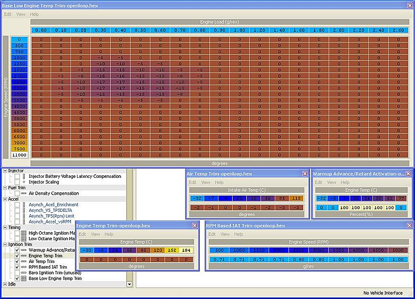

They work just fine for me???

I have my addresses all in my 94170015.xml file and my definitions and scalings in the evo7base.xml file.
Here is what I'm using in the evo7base.xml file:
Code:
	<scaling name="Load8" units="g/rev" toexpr="x*5/800" frexpr="x*800/5" format="%.2f" min="0" max="160" inc="1" storagetype="uint8" endian="big"/>
	<scaling name="Percent255" units="Percent(%)" toexpr="x/2.55" frexpr="x*2.55" format="%.0f" min="0" max="110" inc="1" storagetype="uint8" endian="big"/>
	<scaling name="TimingTrim" units="degrees" toexpr="x-128" frexpr="x+128" format="%.0f" min="-128" max="128" inc="1" storagetype="uint8" endian="big"/>
	<!-- IGNITION TRIM TABLES-->
	<table name="Warmup Advance/Retard Activation" category="Ignition Trim" type="2D" level="2" scaling="Percent255">
		<table name="Engine Temp" type="X Axis" elements="8" scaling="Temp"/>
	</table>
	<table name="Engine Temp Trim" category="Ignition Trim" type="2D" level="2" scaling="TimingTrim">
	</table>
	<table name="Air Temp Trim" category="Ignition Trim" type="2D" level="2" scaling="TimingTrim">
		<table name="Intake Air Temp" type="X Axis" elements="8" scaling="Temp"/>
	</table>
	<table name="RPM Based IAT Activation Load" category="Ignition Trim" type="2D" level="2" scaling="Load8">
		<table name="Engine Speed" type="X Axis" elements="10" scaling="RPM"/>
	</table>
	<table name="Base Low Engine Temp Trim" category="Ignition Trim" type="3D" level="2" swapxy="true" scaling="TimingTrim">
		<table name="Engine Load" type="X Axis" elements="19" scaling="Load"/>
		<table name="Engine Speed" type="Y Axis" elements="20" scaling="RPM"/>
	</table>
Here is what I have in the 94170015.xml file:
Code:
<!--   *** Igntion Trim Tables ***   -->
	<table name="Warmup Advance/Retard Activation" address="41dc">
		<table name="Engine Temp" address="681a"/>
	</table>
	<table name="Engine Temp Trim" address="41a4">
		<table name="Engine Temp" address="6c24"/>
	</table>
	<table name="Air Temp Trim" address="41b2">
		<table name="Intake Air Temp" address="689e"/>
	</table>
	<table name="RPM Based IAT Activation Load" address="41cc">
		<table name="Engine Speed" address="635a"/>
	</table>
	<table name="Base Low Engine Temp Trim" address="3ff5">
		<table name="Engine Load"address="66f4"/>
		<table name="Engine Speed" address="66c2"/>
	</table>
