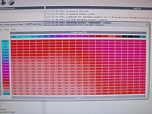

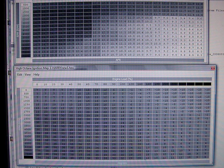

rom map fuel and ign
Hope this works
This is the best I could really do for now.

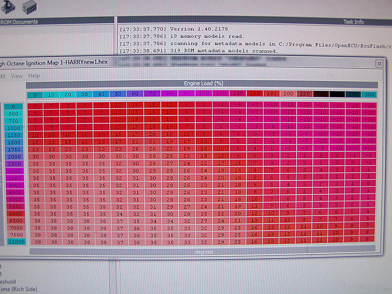

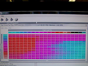

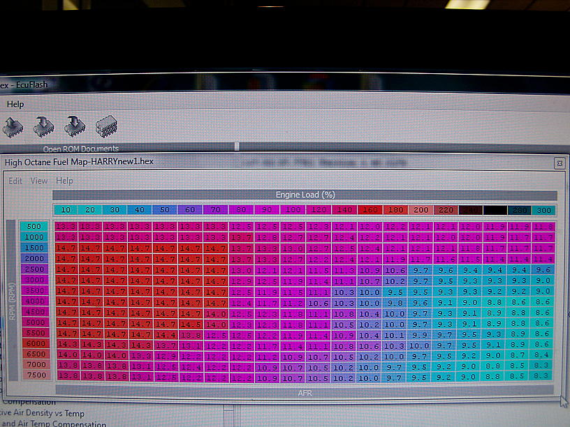

rom
better pics
Attached Thumbnails Tons of knock...need some advice-p1010001.jpg   Tons of knock...need some advice-p1010002.jpg
