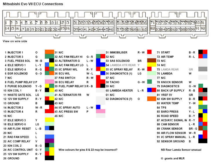

some extra info:
*Swap pins 32 and 34 around
*connect pin 20 to 32
*connect pin 21 to pin 34 (after they have been swapped over)
*disconnect pin 87

The US8 ECU will work too, but additionally you have to swap 8 and 22.
It's not just in the UK that this is being done. Ask Cossie1 who helped him with his swap.
It was yourself that gave me all the info I needed to do the swap originally
As above the USDM 8 ecu will work fine, however there is no SAS control with the USDM ecu, so if you wanted the ALS (anti-lag) effects to work, you would need a JDM 7 ecu.
The 6 ecu can be flashed with the openport 2.0, but you can't go to mad with it, as the xml's that I wrote (and are included with the latest ecuflash) are far from perfect, and most rpm and scaling address's are probablly incorrect, they just "fit" so you can see the rom correctly, as at the time I did them, you could not reflash the 5 or 6 ecu there was no need to make sure the XML's were 100% correct, and I can't disassemble to save my life
