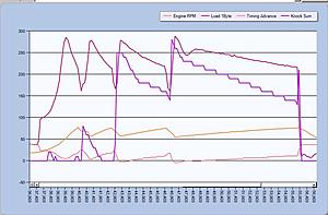

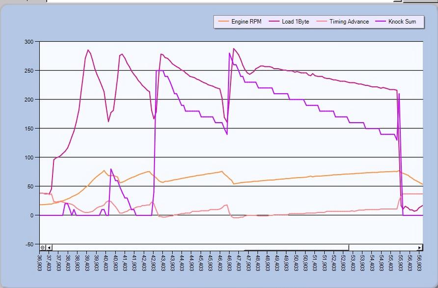

V7 works fine for me except NLTS. I`m getting consistent knock sum of 30-20 counts on each gear if i use NLTS, since I converted to 96530706, but no knock on regular shifts. Anybody having same problems?
I didnt have any knock on V5.1. Anyway I will check my tranny\motor mounts, downpipe etc... May be it is just pure coincidence...

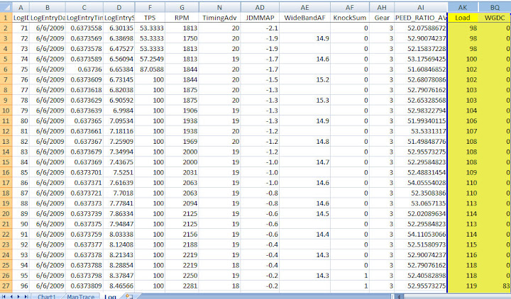

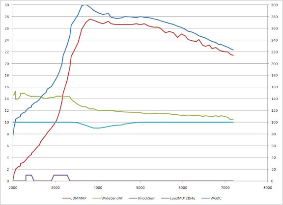

I'm having problems with WGDC on 96530706, after upgrading from 94170015 v 5.10.
No matter what I do, I get 0 WGDC until 120 load, then it goes to 100%. I have 100% WGDC under 180 load, so I don't understand why it's not 100%. WTF. It's making my car very laggy and slow to respond. See my attached rom image. I also notice that the logged WGDC is about 15% higher than what is in my base wgdc map. Could this have anything to do with the fact that 03's start with 100% WGDC and 05's start with 0% WGDC? I logged gear, and it is reading the correct gear, but not following the base WGDC maps. FWIW, when I flash back to 94170015 v 5.10 it's back to 100% WGDC from the get go.
Any help is appreciated.
v5.10 on 94170015 rom
v7 on 9653 rom. notice 0 WGDC until 120 load. Yes I know I need to change my 1 byte load factor to stop it from looping.
Log image
My 9653 ROM settings for boost. Bottom 2 labels are WGDC 100% under load and BCLO

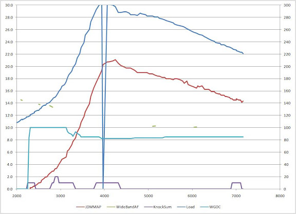

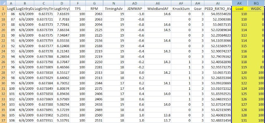

can you do a 3rd gear pull from like 1800rpm? i need to see the bottom end of the load + wgdc + rpm + tps

How's this?
