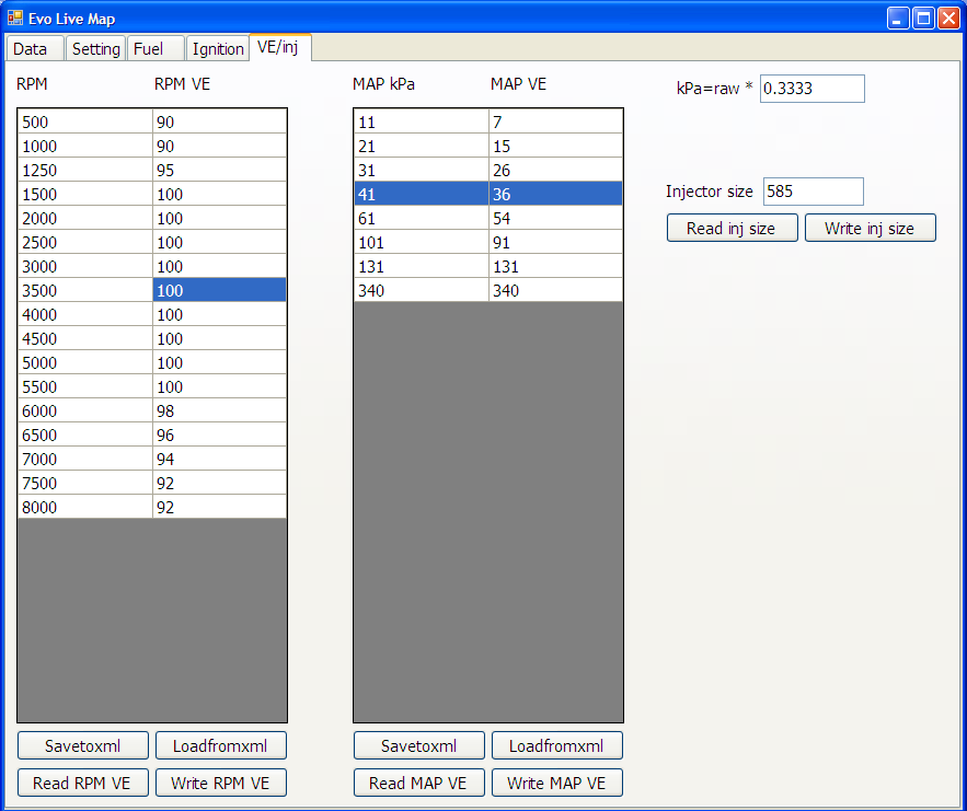

After some confusion i did get this to work on the USDM 9

Bit more work on it as attached - SD VE live mapping.
These tables all have 16 bit values, working on the car.
The RPM VE axis is in ROM, but the MAP VE axis is in RAM. Both the table contents are in RAM.

John, is the alt injector latencies table in RAM, if so could that be added? Wonderful work.
