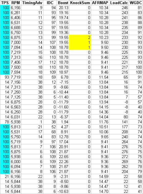

I'm getting some fairly high knock counts (10+) whenever I lift off the throttle (both partial & WOT). It's worst when at WOT, but not at red line. I have no knock anywhere else. Anybody know a fix for this?

Have a log with load? Be interesting to see the difference in load values before and after you let off.

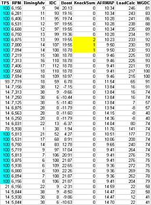

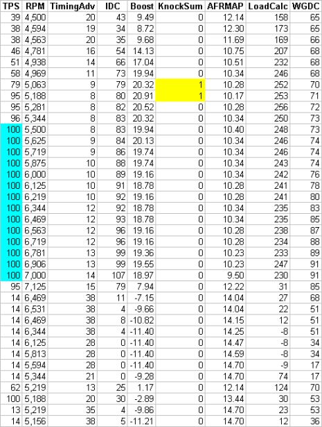

I didn't log load on that run, so I went out and tried to do it again, but now of course the knock is gone ... I'll have to try some other time again.
