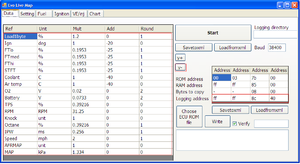

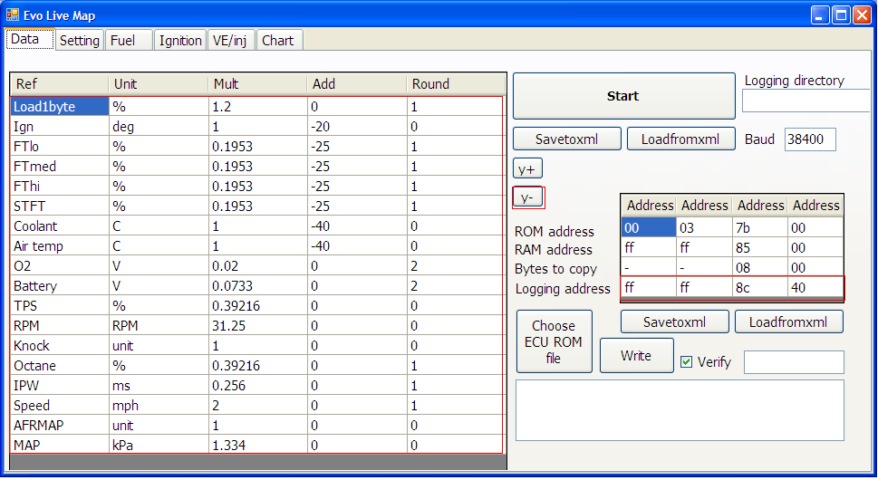

I have put 18 items of the MUT table in RAM for my ECU at the end of the alternate map area, works well and logs fast even if I'm map tracing, graphing and logging to file all at once. I copied them to the ECU RAM using the Ecuflash save. Then I changed and saved the logging table to match the items I'd chosen on the data page (it reads the number of rows you have in this table so use y- to get rid of the rows you don't want before saving). The other change is to alter the address you want to log from in the data tab. No changes to the ECU are necessary. I'll post a screenshot. Let me know if you need any more help to try to implement this. Highlighted in red are the things I changed, your addresses and desired logging items will no doubt be different.
