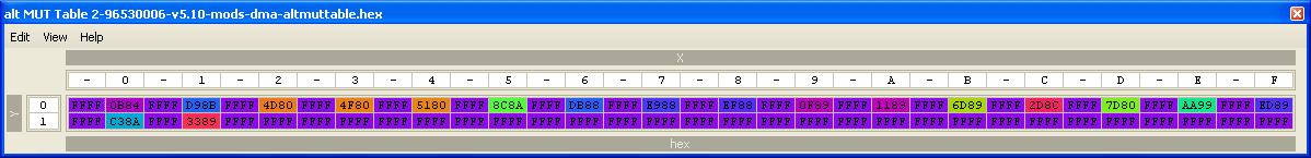

To put the 'alt mut table' in RAM, I added this to my 96530006.xml file in ECUFlash:
Code:
<table name="alt MUT Table 2" category="Misc" address="39200" type="3D" level="1" scaling="Hex16">
		<table name="X" type="Static X Axis" elements="32">
			<data>-</data>
			<data>0</data>
			<data>-</data>
			<data>1</data>
			<data>-</data>
			<data>2</data>
			<data>-</data>
			<data>3</data>
			<data>-</data>
			<data>4</data>
			<data>-</data>
			<data>5</data>
			<data>-</data>
			<data>6</data>
			<data>-</data>
			<data>7</data>
			<data>-</data>
			<data>8</data>
			<data>-</data>
			<data>9</data>
			<data>-</data>
			<data>A</data>
			<data>-</data>
			<data>B</data>
			<data>-</data>
			<data>C</data>
			<data>-</data>
			<data>D</data>
			<data>-</data>
			<data>E</data>
			<data>-</data>
			<data>F</data>
		</table>
		<table name="Y" type="Static Y Axis" elements="2">
			<data>0</data>
			<data>1</data>
		</table>
	</table>
For our 96530006 ROM, John starts the ROM shadow area at 38b00. The 2k blocks, therefore extends to 0x38b00 + 0x800 = 0x39300. So, I opened the ROM in IDA Pro to find some free space in that area. I chose 0x39200, which is an offset of 0x700.
Next, open your ROM in ECUFlash and populate the first 18 entries of this new 'alt mut table' with the variables for John's hard coded list. This is what it should look like:
(You don't have to use this exact same format...you can only show the 18 entries if you wish, but I wanted to keep it in the same format as the main MUT table.)

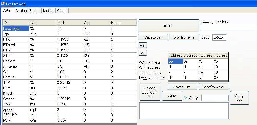

Now, open the new LiveMap with charting app and change the Logging address to the RAM address of this new alt mut table. The RAM address that John chose for this ROM starts at 0xa000. So, we have to add that same 0x700 offset to that to get the logging address for the RAM MUT table, which comes out to 0xa700.
So, the LiveMap logging address should read ff ff a7 00
I changed some of the scaling, for example, to display *F. But, this shows the change in the logging address that you need to do.
Eric
Attached Thumbnails 96530006 Live Map download-alt-mut-table.jpg   96530006 Live Map download-livemap.jpg
