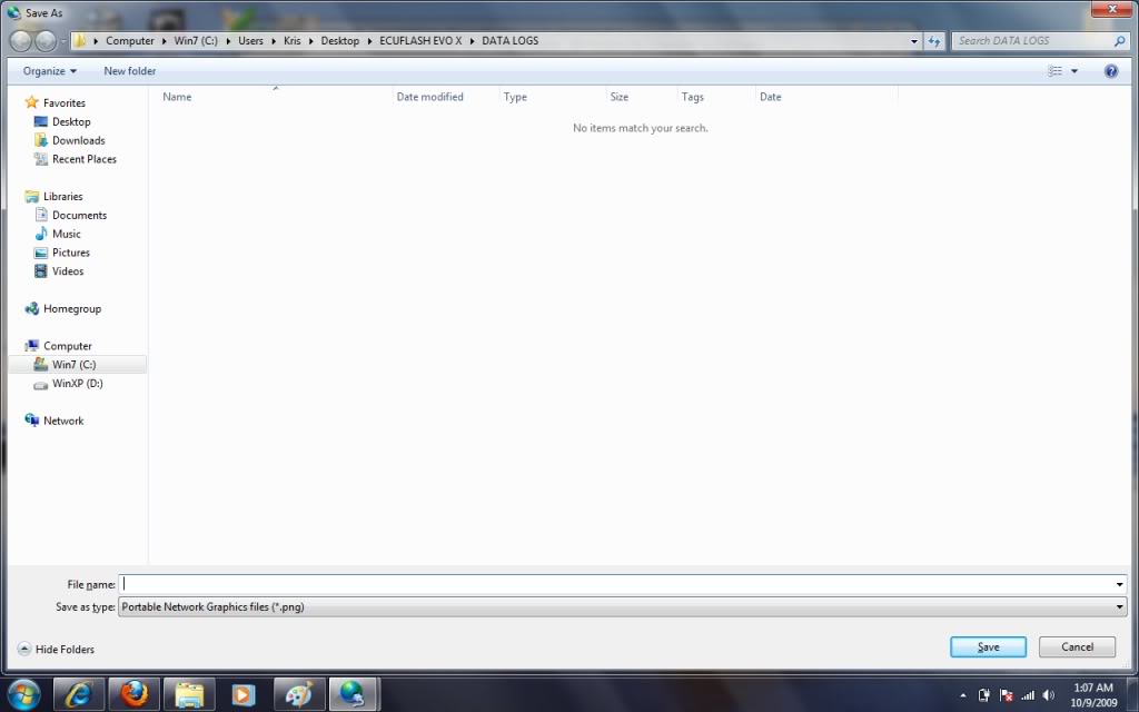

I am using 2.7 beta 5 and for some reason keep get this window after I use EVOSCAN for a day or two. This window will keep showing up. Not sure of the reason. But it only shows up when I try to analyze my logs. It keeps popping even if I close it. It's really annoying since you can't do anything. I tried to uninstall the EVOScan then reinstall it. It works but, I have to go to version 2.6 which has issues with my AEM UEGO. So I have to upgrade again to 2.7. It will work fine for a day or two then out of nowhere it will start showing this save as window constantly when analyzing my maps.
Any idea what is causing it. I am using WIN7 64bit.
