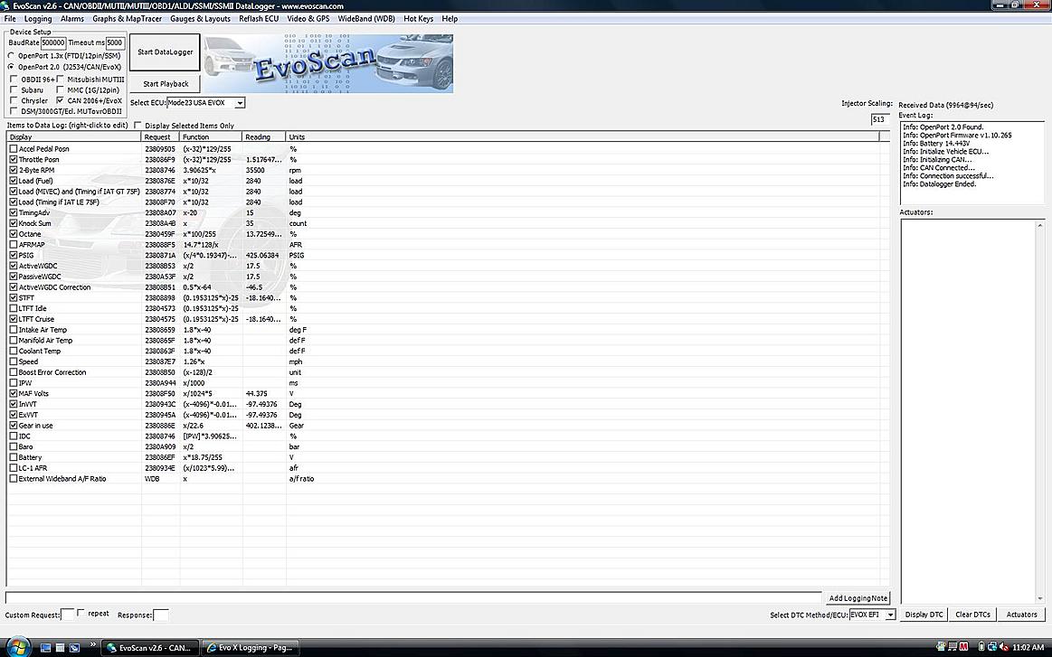

I had mode 23 stop working with evoscan 2.7beta5 the other day. All the values don't change when I hit start logger with ecu "mode23 usa evo x" selected.I uninstalled/reinstalled, and it's doing the same thing. The tactrix cable and connector are working fine because when I switch to ecu "evo x" (non-mode 23) it logs fine, with values switching regularly; also ecuflash works. My other thread got ignored, so can mfred, tephra, or evo4mad help out? Below is a screen shot of what the values are stuck at every time I hit log with ecu "mode23usaevox" selected. Note, those values always read those same numbers when I hit start.

Have you tried logging with tephra's app instead of Evoscan? By doing this you can tell if the problem is with Evoscan. If tephra's app gives you the same logs then the problem maybe with your cable or ECU.

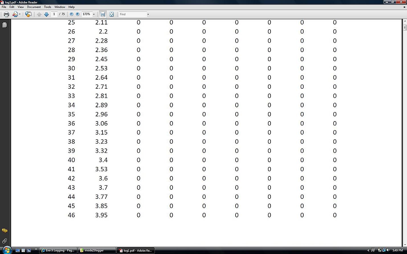

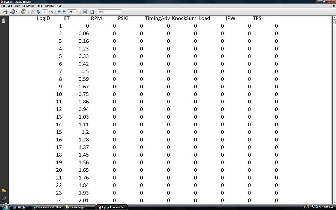

First of all, SIC thanks for helping me out. I downloaded and logged a quick trip down the street with tephra's logger. Below is what came out of it. I tried to attach it, but the attachment restrictions are retarted. I put a screenshot below. there's another 18 pages, but the two left rows only show up.
It makes me think there's an issue with the tactrix connector (switched usb cables-no difference), but the whole ecuflash still working for reading/writing is confusing me.

Okay, so now it seems like the problem is either hardware related or something may be wrong with your ROM. Did you recently change anything in your ROM prior to this?? Something may have disabled mode23 logging by changing one of your maps.
Try this, backup your current ROM and get a clean virgin ROM of the same ROM ID. Enable mode23 in the virgin ROM and write it to your ECU. See if you can log correctly, if all is well, there maybe something you changed in the ROM that disabled mode23.
