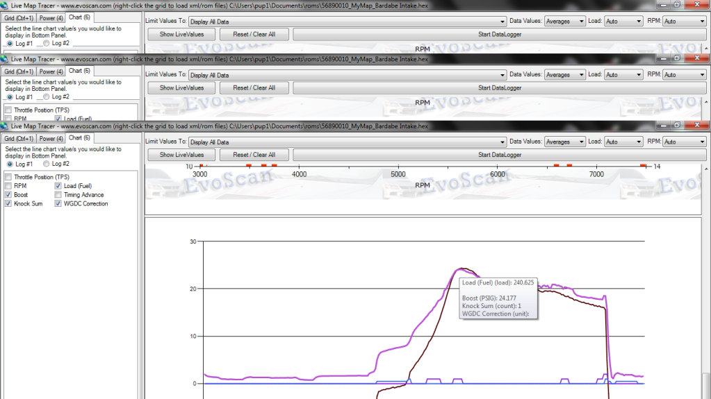

Wasnt sure if this should go in this thread or Goldens loggin boost correctly, but since it pertains to both, Im gonna post in both...
Ok... Been running EvoScan 2.9.017, w/ no issues. Logging Baro/Boost, etc on my 2011 GSR rom 569890010.
I updated the program to 2.9.018... and then noticed there was another update to 2.9.019, so went ahead and updated...
Now when logging Baro/Boost, Boost is WAYY off! in the 38.x psi region... (yes Baro is before Boost, yes the address's are matching, and yes I tried the new eval for Baro) Ive tried this on .017 (again), .018 (twice), and .019 (twice) now and same results. Didnt know the 3Bar read past 30 ish...
I know the car isnt seeing that much boost as the ASC isnt triggering limp mode (still enabled), the car isnt seeing any "-" Corrections, altho, its not seeing any "+" Corrections either... weird! (Yes Corrections vs. TPS is stock +10, and I have + corrections set up)
Now the car is down -20+ load, and down on power from the previous tuning session.
Now... If I change the eval for Boost, take out the [Baro], and set it to -14.3, Boost reads 24.4 (1psi down), and load is still -20 down from where it was... According to VD, power is down too!
The stock BCS's are maxed out so NO boost changes have been made! Its maybe, 10* warmer. I dont recall 10* temp change having this much affect, if thats the reason boost/load is down a lil...
Not sure whats goin on here... Heres a SS of baro/boost, and another SS of boost w/ out the baro.
Baro
w/out Baro
Did I mention, Im down a -20 load and NOT Getting ANY + corrections! Target loads are set to hit 270, as I was hitting 26x ish loads.

Would changing the priority to 50, have anything to do w/ this ^? any1 else seen this?
Also, now if I were to go back to logging boost w/out "Baro" would the correct formula be
"(x/4*0.1953125)-14.3" or "(x/4*0.19347)-14.3" ?
I'd prefer to use the baro compesation if I can get it logging properly...
