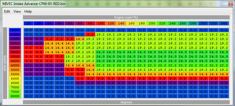

For reference, this is the MIVEC map I'm using on the FP4R's (and the one I gave the OP). I have SuperTech springs & retainers.
I did get a lot of midrange knock, and I occasionally still do, especially in low gears. I may try pulling down the 3000-4500 to 19.2 to see if that heals it.
I'm running a very tame ignition timing map at peak torque as well, same symptoms, can't eliminate it easily.

Even the above MIVEC map isn't that great for 4R cams. You should be running max advance of 28.8 from spool-up through the mid-range.

Here is what I've found to work the best on the dyno (also notice the negative values in the idle range).
Did you look at mine?!
Yup! Yours looks good to me too.
Contrary to what FP recommends on their site, being aggressive with the advance causes consistent and high knock counts with the 4R's. That's the problem that the OP and I are seeing, it isn't the solution (in our case).
Believe me, I started off with much more advanced cam timing and assumed it was my ignition timing that was causing the problem... but after I went from 8-9* on the stock cams all the way down to -2* on the FP 4R's and STILL getting 7 counts of knock I faced the facts that 28.8* of cam timing was too much.
