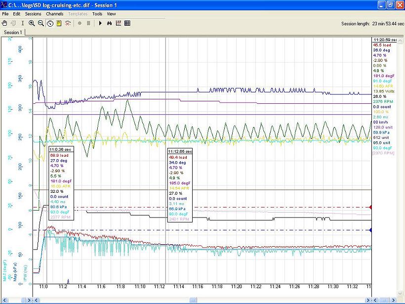

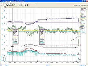

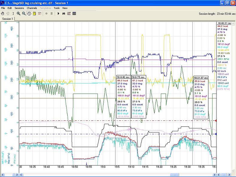

OK, I went for a couple long cruising sessions today to tune my SD. This 1800-2400 RPM range issue isn't just in my head. I'm looking at my logs now in Logworks. I think there is just rapidly changing VE in this area that I'm not accounting for in my VE maps yet or something. It's weird that it's just this small RPM range at a small map range, too.
If I am at a low throttle and slowly going through this range, I get the issue. The log verifies it by a very slightly bumpy RPM line and a pretty bumpy IPW. The IPW line is a bit jagged up and down, but just through that little RPM/MAP range. Once I get past it, it's fine, or if I go through the range at higher throttle, it's seems to be fine. I've tried a bunch of combinations of RPM VE and MAP VE, but nothing seems to have worked yet.
I just started studying the logs, so maybe I will find something, but just wanted to post up, in case anyone has an idea or similar experiences. I don't think most people will be in this range, but I tend to shift and cruise so I am just above 2000 RPM, so I hit this range a lot.
EDIT: OK, I think I have narrowed it down to 65-85 kpa/1800-2400RPM. Both of those have to be true for the issue to show itself.
Here are three areas of that log to illustrate what I mean. It may be hard to see with a lot of crap here, but the bottom half of the graphs are the area to look at. I have two markers for the RPM range, which are dotted red and blue horizontal lines. The IPW is a light blue, load is red, RPM is light purple, map is blue:
This is right after a shift, coming into the problem area. Even though I stay in the RPM range here, once the map drops below 65kpa, everything smooths out. Notice the jagged IPW in the trouble area.
The left side shows the trouble, the right side shows normal. Notice once I get over the RPM range, everything smooths out nicely.
This one shows a good example of a nice smooth IPW on the left side of the graph. Then, when I cruise through the trouble RPM zone at the right map, you can see the jagged IPW and even a couple areas of jagged RPM. It almost feels like very minute repeated fuel cuts.
Besides this one little nuisance, everything else drives 100% perfectly. WOT is perfect, idle is perfect, cruise is perfect outside this particular RPM/MAP zone. LTFT Lo and Mid are right around 0. As long as I can figure this out, it will be 100% done.
Eric

I did not see this and a considerable part of my commute was under these conditions.
Load looks a bit bumpy there as well as RPM which is probably effect rather than cause.
A few things I thought of:
What about logging 16 bit MAP in this area to see if there is more noise?
Could there be electrical noise in the MAP signal or even cam or crank position sensors? Do you have your MAP signal routed near sources of noise?
I don't think is near the over-run fuel cut off or closed loop thresholds which probably have hysteresis on them anyway.
I may be off base, but the outputs of the SD calculation are load and IPWload, since they work normally most of the time that is why I'm suspecting electrical noise.
Odd one though!

Well, I'm using the OMNI 4-bar map sensor, which is usnig the stock MDP harness. So, there isn't any unusual routing or induced interference on my part.
I was thinking about logging a better resolution map. The map in the logs is pretty much dead flat, but the resolution isn't that great. I do agree that the load looks a little bumpy as well, but not as much as the IPW would suggest. That's what strikes me as odd. Nothing else in the log really indicates what is going on here. The only thing I could possibly think of is that the map is fluctuating there, like you suggested, but I can't see it without the 16-bit resolution.
OK, so the next obvious question in case I can't find it....what variables do I log for 16 bit map? I remember seeing a discussion on this somewhere, so I will start searching.
Thanks,
Eric

16 bit MAP is the input to the axis "SD MAP sensor VE and calibration" table, so IIRC how the Mitsi ECU works (I'm afraid it is getting displaced by other junk) it will be in the header.
From a log you should be able to replicate the calculations that the SD conversion uses from the two VE tables, RPM and MAP, so you know what the non temperature compensated load will end up as. Thing is, if it works with expected load values in all other situations, I can't see why it would be wrong. Junk in = junk out hence why I wondered about interference, but using the stock wiring would suggest otherwise.
Could the timing be funny in this area? Might be worth using more or less, turning closed loop off etc to see if it goes away.
Old Jul 26, 2009 | 09:10 AM
  #56
l2r99gst's Avatar
Posts: 3,499
From: CA
Timing is the dark blue line at the top of the logs. It is in a transitional area and I was thinking about just blocking that area as a test. However, I think my loads are matched pretty well from my MAF logs, so this should be the same area that I was hitting previously.
OK, I should have enough to try now at least. Thanks for the input.
Eric
