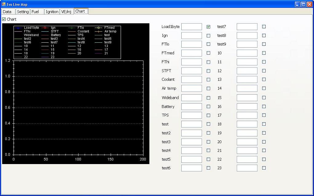

In the meantime, what do you guys think about a black background for the LiveMap chart? Is something like this better, or do you prefer the white? Also, here I put in major gridlines for the Y axis. Good/bad? You can see a comparison screenshot on the previous page:
Since I have the code working how I want it now, I am going to clean up the colors and symbols on that chart so that all of the colors are visible. I may make one exe with a white background and one with a black background.

Haven't officially tested this yet, but all I did was change the colors, so I don't see them not working. Here are two different exes...one for the white chart background and one for the black chart background. I tried to choose better colors and when I reused them, I added a symbol to the curve.

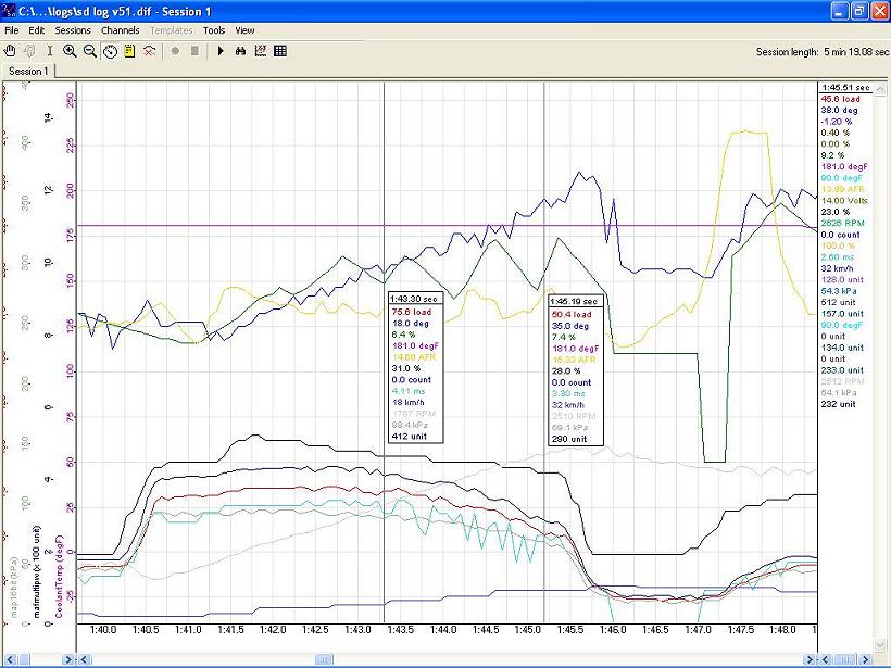

Anyway, here is a new log. This time I used my old v5.1 tephrarom with DMA/livemap. I didn't put the SD maps into RAM though, since I already have them tuned from the previously logs with v7t6.
I flashed the car and went for a cruise to go gas up. It actually seemed a lot better...but I did notice the slight hesitation, jerkiness, so I knew the issue was still there. Here is the log, with 89ac+89ad included (MAFMULTIPWARMUP).
Looking at the bottom half of the log, the top black line is TPS, then one down is MAFMULTIPWARMUP, 1byte load (red), IPW (light blue), 16bit map (light gray?), and 2byte RPM angling up through them.
I put vertical markers to show the trouble area. Again, like clockwork, it starts at about 85kpa/1800RPM and lasts until 65kpa/2500RPM. The other lines are bumpy as well, but what I would expect to be normal. Nothing jumps as much as the IPW does...MAFMULTIPWARMUP does seem to slightly coincide with the jumpy IPW, but not entirely, and it doesn't seem to be as much. So, it's very confusing as to what exactly is going on. The VE is relatively flat in this area as well, so any interpolation shouldn't be too big of a jump...but maybe that's where I need to concentrate again. I remember making a 3-d chart from my 2 VE tables and comparing this exact area to the 3-D chart from my MAF log and everything is very close.

Good graphs, but the only one that looks funny is the IPW, so it doesn't show the SD variables misbehaving, and I'm starting to think this is not related since the SD is just changing the variables you've logged and they are working. I'm afraid it will need testing to the point where you have a proven stock(ish) ECU setup that doesn't do this, and then add back in the minimal elements of the SD conversion to see if it then reappears.
It is a bit tricky with the labels and colors to see what the STFT and Narrowband O2 (which is close coupled, fast and great for seeing oscillations around stoich) does during this time. Have you tried turning closed loop off to see if it still does it?
STFT is the sawtooth in the graph, just above center. There looks to be no correlation with the jagged IPW and the STFT. I agree that it may not be the SD patch entirely, but this issue only came about when converting to SD. It may possibly be some other patch interfering with SD or just a coincidence that it showed up when I made the switch, with no correlation. To be sure, I will also flash back to my MAF ROM to test.
