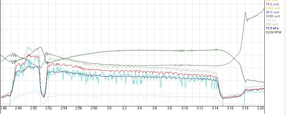

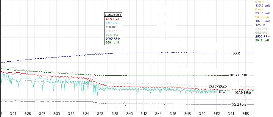

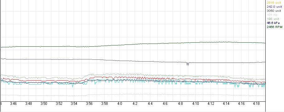

OK, here we go...here are some screenshots, followed by the two logs (way to the gym and way home). I have a lot of other things logged, but with DMA, it doesn't matter...just hide those.
This shows the jagged IPW, with the other curves labeled....IPW smooths out once past the 2500 RPM mark:
This shows another area while cruising in the trouble zone:
This shows cruising outside of the trouble zone (map too low), with a smoother IPW:

Ah crap...the .dif files are too big. Zipped up, they are about 150kb, too big to post. Let me know if you want me to email them to you.
I wonder maybe if this is some sort of misfire, since gear head mentioned he even got a P0300. My plugs are due for a change, but this doesn't happen with the MAF, only SD. I can flash back this weekend to double check again.
Eric
